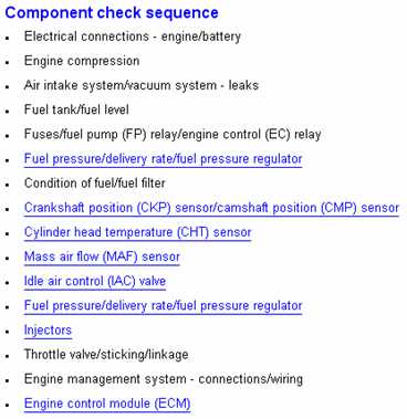

Tezky start, benzin:
tezky start_teply motor.jpg (12.14 KiB) Zobrazeno 2267 x
tezky start_studeny motor.jpg (20.35 KiB) Zobrazeno 2789 x
