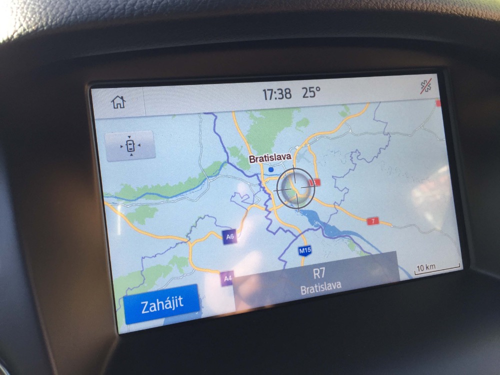

edit: Tak som nakoniec zvitazil :) Stiahol som verziu 3.4 19101 aby som mohol re-formatovat Sync, medzi tym som znova v manual mode stiahol vsetky subory na verziu 3.4. 23188 aj s mapovymi (kedze nemam inu 64GB flashku, tak som to riskol na povodnu, len som ju nanovo naformatoval) posedel som si v aute 49 minut, striedavo s nastartovanym a vypnutym motorom, ale zapnute zapalovanie. A mapy a navigacia funguje... Vdaka vsetkym za zaujem a za rady... :palec_nahoru:

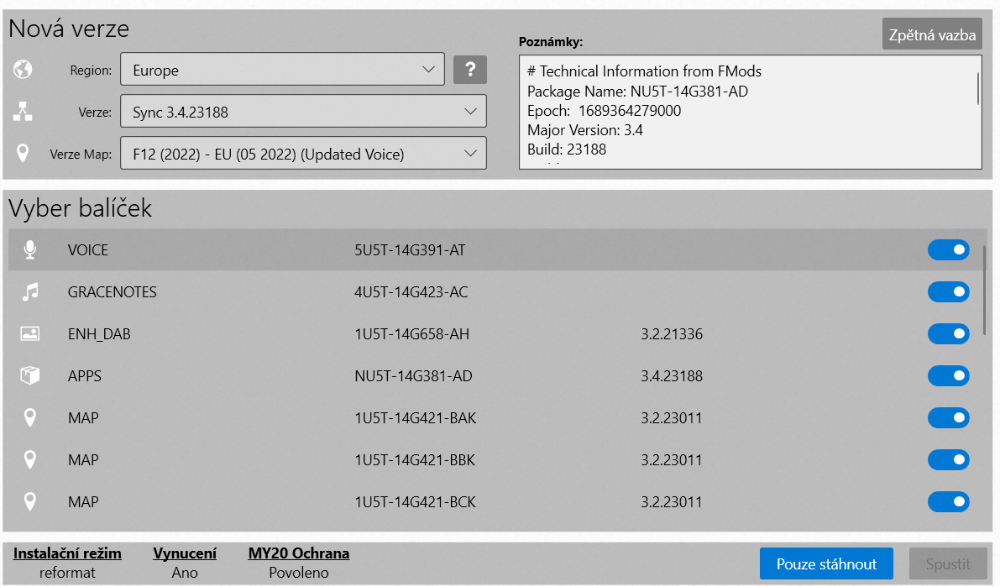

Zde je LOG:
CYANLABS - SYN3 UPDATER - V2.12.5.0
Branch: Stable
Operating System: Microsoft Windows 10 Home (2009)
PREVIOUS CONFIGURATION
Version: 3.4.22251
Region: EU
Navigation: True
Install Mode: reformat (reformat)
Install Mode Overridden: True
My20 Protection Enabled: Zakázáno / Bez MY20
DESTINATION DETAILS
Mode: Drive
Model: Kingston DataTraveler 3.0 USB Device
FileSystem: exFAT
Partition Type: MBR
REFORMAT.LST
VOICE=5U5T-14G391-AT_1660763323000.TAR.GZ
GRACENOTES=4U5T-14G423-AC_1615425645000.TAR.GZ
ENH_DAB=1U5T-14G658-AH_1644006443000.TAR.GZ
APPS=NU5T-14G381-AD_1689364279000.TAR.GZ
MAP=1U5T-14G421-BAK_1682464992000.TAR.GZ
MAP=1U5T-14G421-BBK_1682466740000.TAR.GZ
MAP=1U5T-14G421-BCK_1682467250000.TAR.GZ
MAP=1U5T-14G421-BDK_1682467734000.TAR.GZ
MAP=1U5T-14G421-BEK_1682467790000.TAR.GZ
MAP=1U5T-14G421-BFK_1682467908000.TAR.GZ
MAP=1U5T-14G421-BGK_1682467948000.TAR.GZ
MAP=1U5T-14G421-BHK_1682468092000.TAR.GZ
MAP=1U5T-14G421-BJK_1682469041000.TAR.GZ
MAP_LICENSE=1U5T-14G424-BM_1683133039000.TAR.GZ
VOICE_NAV=4U5T-14G422-BAK_1682464728000.TAR.GZ
VOICE_NAV=4U5T-14G422-BBK_1682464776000.TAR.GZ
VOICE_NAV=4U5T-14G422-BCK_1682464838000.TAR.GZ
VOICE_NAV=4U5T-14G422-BDK_1682464885000.TAR.GZ
Naposledy upravil(a) Mikesaak dne 22.04.2024 14:50, celkem upraveno 1 x.
