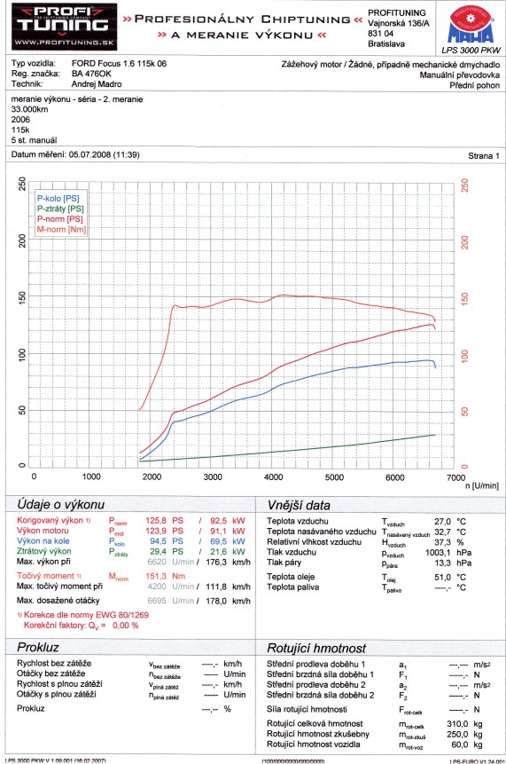

dovolim si vstupit do tejto diskusie. Nemyslim si, ze by sa po prekrceni 4500 otacok zacal zatvarat privod vzduchu, nedava to logiku. Podla merani na brzde, ktore som robil na mojom aute, to sice vyzera, ze krutiaci moment ide dole (meranie 2.0 Duratec, ale to iste sa deje aj pri1.6 TiVCT, takze podla merani to tak nie je.

tak som to nasiel a je to tak ako som pisal. Nie som sice super v anglictine, ale tu sa pise o tom, ze klapky su zatvorene pocas statia napr. na semaforoch a otvaraju sa pri plnom vykone.
The tumble flaps are fitted in each of the intake runners close to the cylinder head flange. Controlled by a solenoid actuator, they are closed during light-load operations, such as idling at traffic lights, shifting actions and deceleration, to maximise combustion efficiency, fuel economy and emissions performance. The valves are fully open during higher load conditions to maximise volumetric efficiency and power output.
