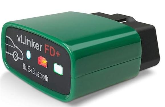

Ako si mam vysvetlit tu "zistenu zavadu" ked test 6 dolezitych systemov bol OK? Daka chybna komunmikacia medzi OBD adapterom a appkou?
Pouzivam tento BT adapter, ktory by mal s Forscanom android apkou bez problemov fungovat
2024-12-10 12_12_07-Amazon.com_ Vgate vLinker FD+ OBD2 Bluetooth Scan Tool, Diagnostic Code Reader f.jpg
